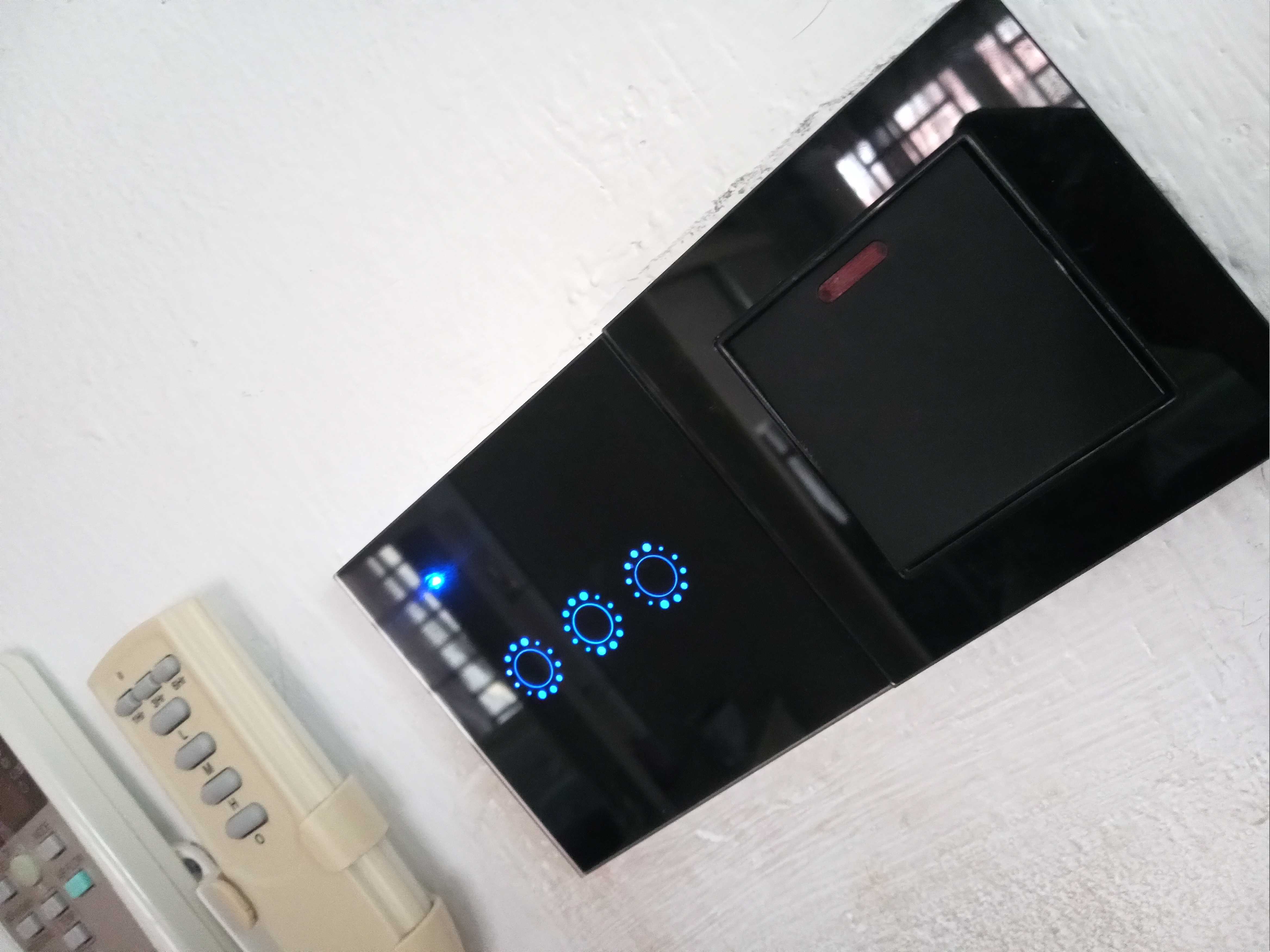

1. Google home : 4 units (living, dining, kitchen, master bedroom)
2. Wifi wall switch : 8 units (living, dining, kitchen, all rooms)
3. Ir wifi hub : 3 units (living, dining, master bedroom)
4. Rf wifi hub : 1 unit (dining)
5. 13A wifi socket : 2 units (kitchen)
1. Google home for asistant.
2. Wifi wall switch for home lights & fans.
3. Infrared hub for connection to 3 tv, 2 astro, 3 android box, 1 home theatre, 3 fan speed, 3 aircond.
3. Radio freq hub link to existing home alarm system.
4. 13A wifi socket for kitchen appliances like thermosflask, etc.
Total lost : Below RM1k

TT and Tuan siamanggagapp nak tanye kalau plug suis tukan run wi-fi/wireless 24/7 untuk bil eletrik ade effect tak?
logically mmg akan lakan, tapi besar tak beza dier before implement smart home dengan tak?
Setakat ni tk rasa pulak bezanya. Sebab 1 rmh pn dh upgrade tukar LED lightning. So bil tnb rmh skrg ni jd lg murah average dlm rm70 sbln. Aircond 1.0hp on tiap2 mlm nk tido.

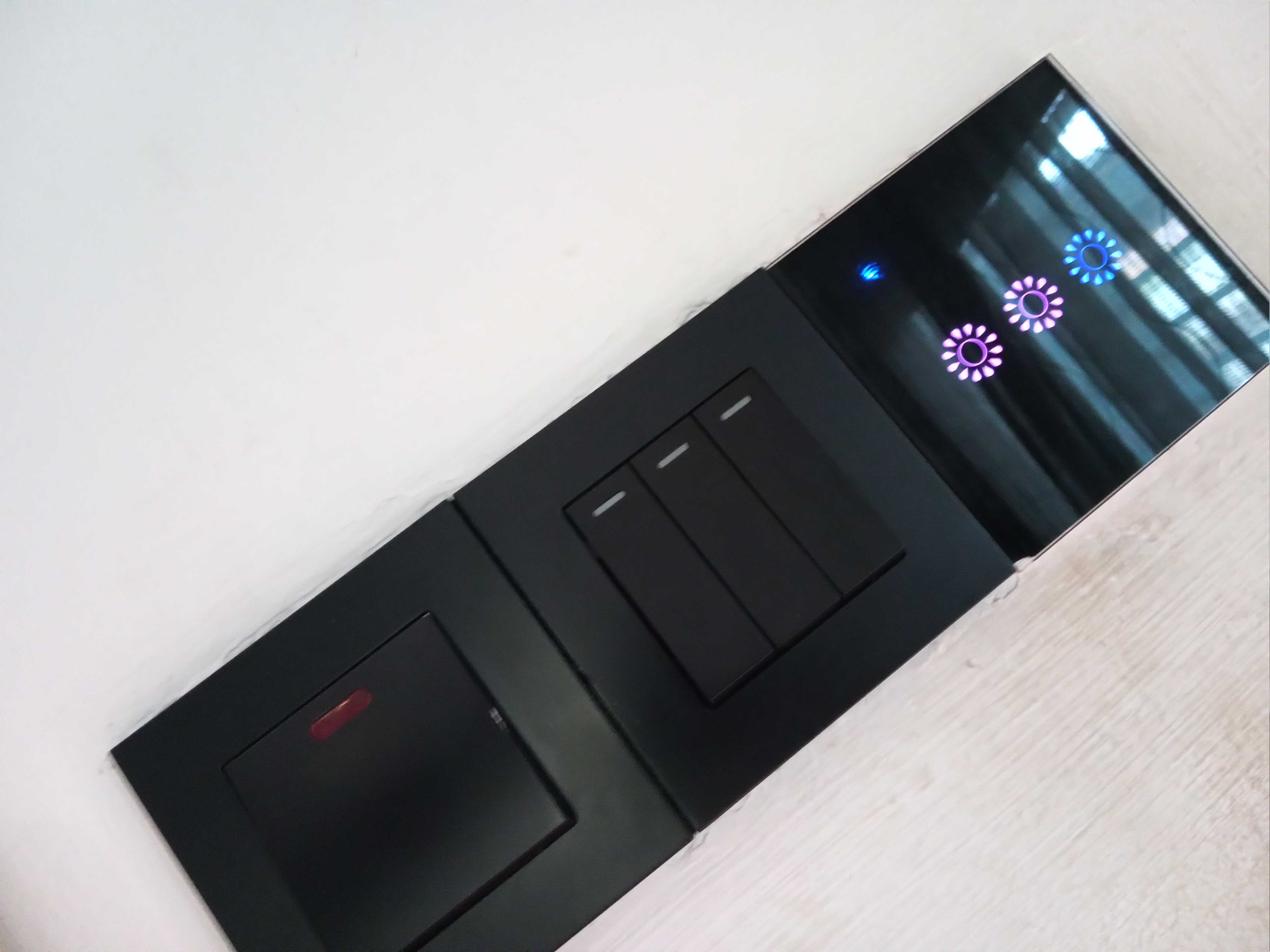

stakat ni dah tukar 3 gang wall plug, sonoff basic dekat plug room 2, lampu luar rumah dan TV

Tuan brand sonoff kalau plug 3 gang tu kene ade neutral wirekan?
