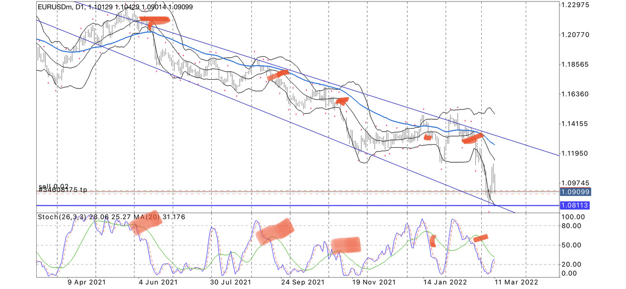

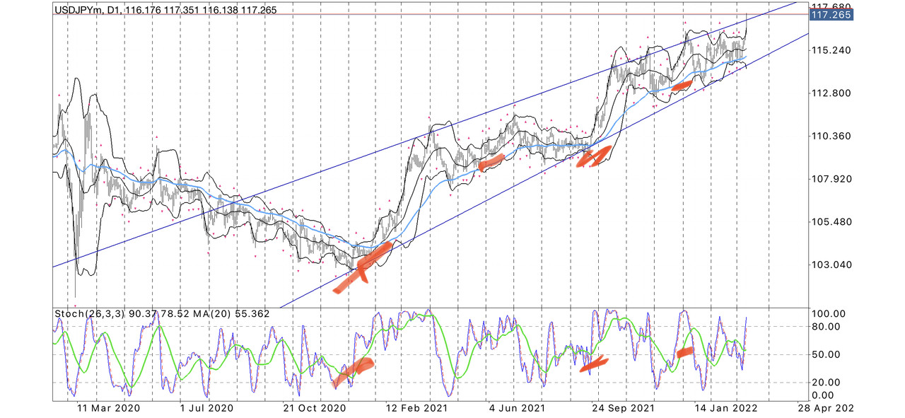

Ini setting sy guna Bollinger band + ema 72 (3 days) + stochastic 26:3:3
First, bro buat trendline pd weekly/daily chart
Pastikan line tu sentuh at least 3 touch berturut2 atas n bawah band
Dr situ bro dpt kenal pasti line paras harga rendah dan tinggi & sapot resistant paling kuat, nak scalp pun senang
Kalu daily chart above middle band
Scalp ke arah bullish
Bolinger band membantu dr segi volatile bounce naik dan turun
Above middle band - bullish
Below middle band - bearish
Then, masukkan ema 72 utk syarat kita masuk sell jika below line, buy jika above line
Mcm di bwh ni
Utk trend bullish - buy above band 20
Utk trend bearish - sell below band 20
Jgn masuk bila consolidate middle band
Stop lost bro bole letak previous hi/low atau lihat stochactic
Stochastic juga bole kenal divergence
Semoga berjaya
Jgn lupa buat back test
