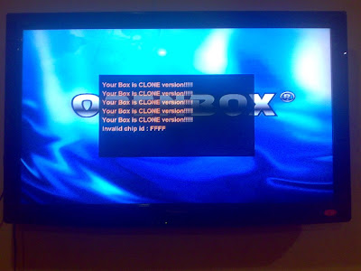

IMAGE MENARIK LAGI MENGERIKAN...
KEBANYAKKAN KES NI BERLAKU APABILA MACHINE FF-FF-FF-FF-00-00-00-00 TIDAK DPT MEACESS CHIP ID ORI.BKN SEBARANGAN FIRMWARE YG BOLEH DIUPDATE KE DECODER YG SEGEGINI....
LIHAT PERBEZAAN
SALAH SATU FIRMWARE YG DAPAT MEMBANTU..OPENBOX_S10_Asia_V3 UNTUK MENYAHKAN ID CLONE FFFF
