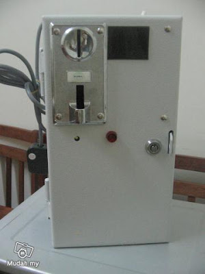

harga tu kire best prize saya kasi,ok la modal pun tak besar mana.
kalau dah pasang 1-2 bulan bole balik modal.
untuk anda yang ingin membuat perniagaan kecil-kecil atau pasif income.
suitable for using in many business example self service washing machine(can connect with home washing machine )
Specification
* W17 x D16 x H31cm
* multi coin input ( 10sen,20sen,50sen )
* Adjustable amount ($0.1 to $9.9)to start up
* Adjustable timer 1 to 99minute (using 2 micro switch).
* Max.countdown 99 minute.
* 2 Round lock (out door , cash box)
* One pilot light (blinking during last minute countdown)
* Buzzle sound (during last minute)
* Can be mounted on wall or on table
* 2 relay switchs
* 3 digits display

kalau aku nak setting machine coin aku kat penapis air bleh tak? mcm boleh modified jer.. coin machine tu akan control elektrik kan? so bleh control pam air keluar masuk utk penapis air la ek?
