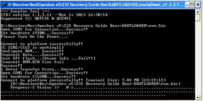

The program for the firmware software via RS232.How to use it.
1. Set UART upgrade tool.
2. Start the UART for refreshment.
3. Connect the RS232 (same as on the Dreambox).
4. Set the COM port. 9600
5. Select the firmware file you want to upgrade the software.
6. Click Update.
7. Turn on the receiver.
8. The program will install the firmware from 0% to 100%. Wait successful ...but this is not the end. Just turn off the receiver.
9. The screen receiver will load from 001 to 100.9. Wait until the screen receiver is finished
loading.The whole procedure takes about 10-15 minutes.
https://app.box.com/s/ayo372m7oimbbblft471
aku try buat, sangkut ... dia stuck...juz tulis.
Connect Success!
Please Open STB...
HandShaking with Slave...
tu jee... takde respon ape2...
ape kes tu bro?
