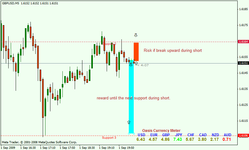

Meter Reading utk JPY = 1.
dekat chart, GBYJPY break snr. Break bermakna, new candle at TF15 completed and formed above the resistance line. utk setup ni, saya double check hi-lo. kalau masih within daily range, saya akan BUY:
EURJPY, GBYJPY, CADJPY, NZDJPY, CHFJPY, USDJPY.
details explaination post 1449

3. kadang2, bila strength tunjuk extreme condition, we are already too late. trend is over, disebabkan market hit major S&R
Best time to OP
setiap session open.. refer post #588
Or lepas news whipsaws tu abih. follow the trend.
Or, at the point of strong weekly SnR, di mana kita bleh expect dia akan bounce. expecially kalau candle baru first time jejak kaki ke situ. ini kira countertrend. agak merbahaya. tapi kalau weekly psychological S&R tu kuat, insyaAllah bounce. kalau dah 2-3 kali price dok ketuk2 S/R tuh, jaga2 sikit. kot kot tembus.
SnR tu adalah Zone. bukan sebatang line jek. kalau tak betul2 lepas, nnt dia patah balik.
make sure, score pada masa nak OP tu, lebih "4" beza antara dua currency tu. macam td ni, GBP 1, USD 5+. kira cukup kuat utk tarik gbp kebawah selepas break support.

Money Management
general rules apply.
untuk scalping: total 10% of your equity.
contoh. jika anda OP 7 pair. modal adalah usd1000. leverage 1:500.
kita guna margin 100usd. bermakna 100*(leverage) = 50,000. so, leh trade 5 mini lot total. kira le bahagi 7.
example HERE
untuk intra day. OP pagi japan market. yg ni kita buat layer by layer.
open post 2% of total equity. eg, when the pip naik jadik 100 camtuh, add satu lagi layer.
RISK & REWARD
kelebihan.
1. scalping multiple currencies. tak payah stick to one pair only.
2. jelas dan nyata mini trend yang ditunjukkan.
3. bagi saya, confidence level tinggi sebab kita follow apa org ramai2 buat.
